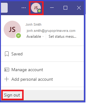

3. A new instance of Teams will open. If it starts with Grupo Primavera account, you need to Sign out and Sign-in with you Cegid Account, Otherwise it's done.

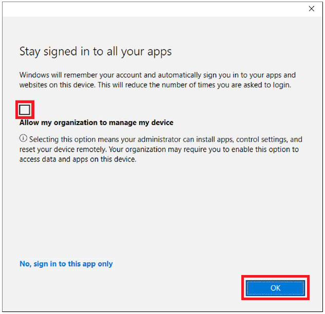

4. If the next window appears, uncheck the Option "Allow my organization do manage my device" and click OK.
b7213100-d9d62df8-63e61befd7f1d7.88874152
