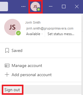

4. A new instance of Teams will open with Grupo Primavera session, you need to Sign out.

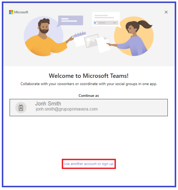

5. Sign-in with Cegid Account

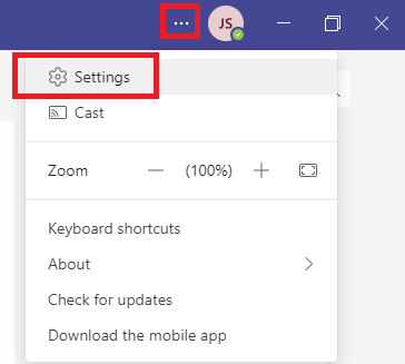

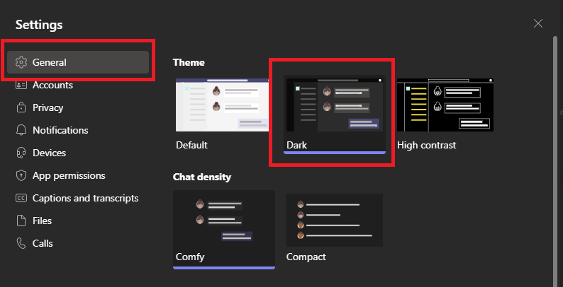

Tips for Cegid Teams
1- Change the Theme
Change the Theme of Cegid Teams to help distinguish from Grupo Primavera Teams.
You can change it in settings.

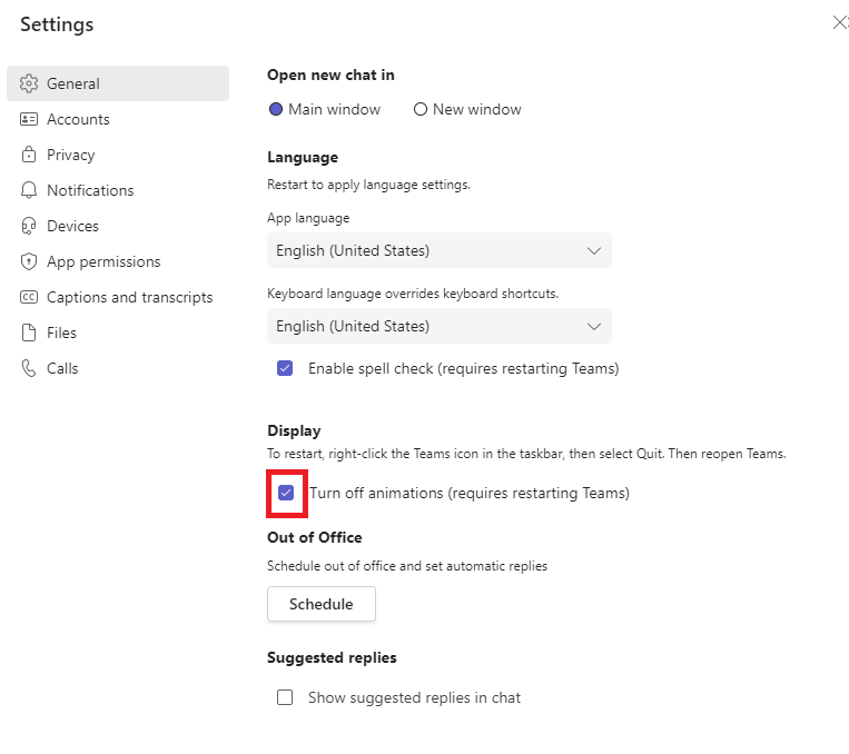

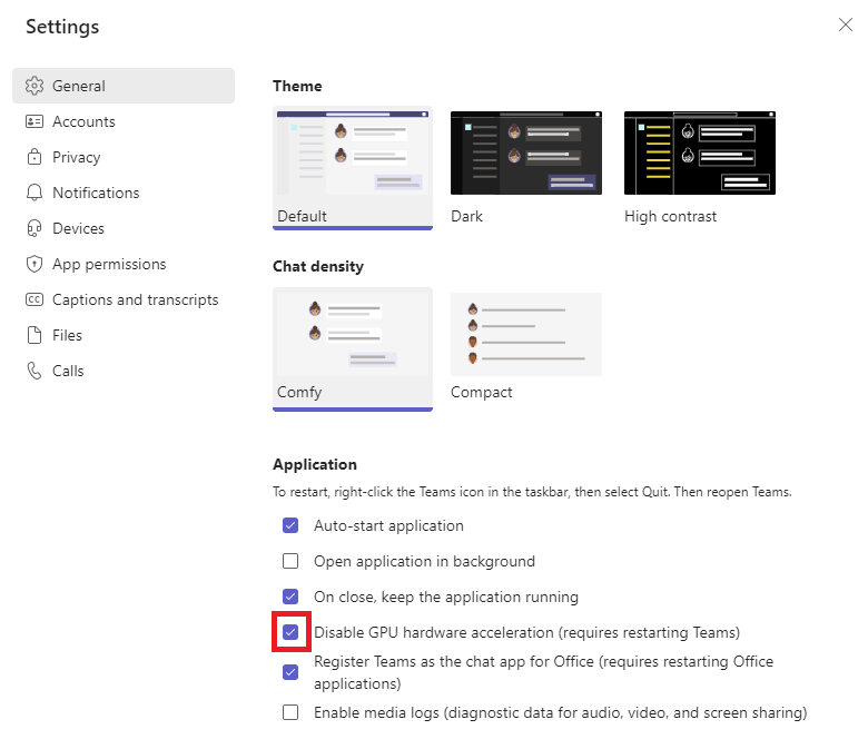

2- Improve Teams Performance
2.1 - In Teams settings activate this two options:
"Disable GPU hardware acceleration" and "Turn Off Animations".
d90092e2-d9d62df8-6392598a5041f5.35557715
d90092e2-d9d62df8-63925969d66aa1.58421847
